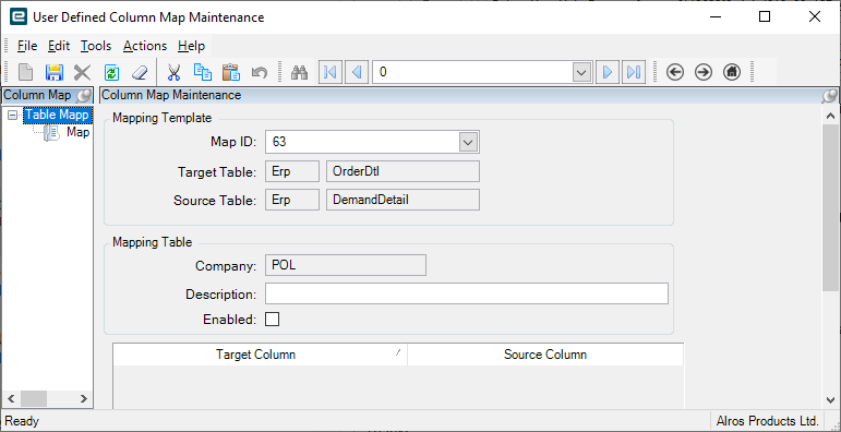

You do not need a BPM, just map the column under UD Column Map Maintenance

You will have to add UD fields to the Demand and Order tables. UD fields under D go to Demand Details and Order Detail. UD fields under SCH go to DemandSchedule and Order Release. So fields will have to be added to both Demand and Order tables. Once done you can make the mappings in the screen above.
