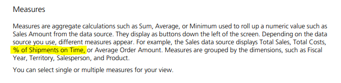

Anyone know how to add a calculated field to EDD? Need to get a percent of. According to their guide you can add said field. But I don’t see how.
I thought all of the EDD fields had to be calculated in the BAQ? You can look at all of the zHomepage BAQ’s to see how @bconner built them all.
That may be the case. The EDD documentation isn’t very clear.
Do you think I should do the totaling and calculations in the BAQ then?Rather than totaling in EDD.

I’m hoping that some day Epicor will add some more features to EDD. For example calculated fields.
For EDD, calculations should be setup up in the source BAQ. EDD is shy on functionality. If you want to perform calculations the more robust EDA application is what you want. Syncs ERP 10 data to cloud.
Epicor’s EDA has much more BI functionality…
