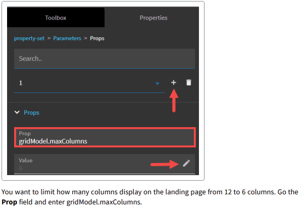

Thanks guys. I did peruse all of these resources but can’t seem to find what I’m looking for. Let me rephrase my question.
Using a grid as an example, the guide says to set the maxColumns prop of the grid:
How can I find all the properties of said grid? Kind of like shown in this post:
Property-set values - #5 by isnaeni.nurfalah?

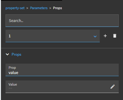

I found the reference guides. For my use case, this was for combo box and I found the property name I needed “value”.
