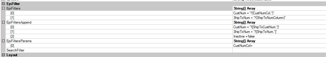

Edited- This is a terrible example, see post 4 instead.
The filters defined in the EpiFilters section are ignored since they are not defined in the EpiFiltersParams.
The filters are defined in EpiFIltersApped are used instead, set directly to the dataviews column with ‘?[]’.
Hey Jim.
Thanks for this.
I see the screenshot but I’m confused by what’s going on.
For example in EpFilters, where is ShipToNumColumn coming from?
Also, how does it know which dataview to use?

I’m sorry, that was actually a terrible example…
  • Left side would be the dataset column from EpiBOName “CustCnt”, so CustNum
  • Right side would be the column from your QuoteHed dataview, which is CustNum
There are two syntax types you can use. Here is the first:
  • CustNum = ‘?[CustNum,0]’ (The “,0” is used to default if the CustNum is not found)
The second way is to define a parameter and assign it in the EpiFiltersParams section. This method has to do with reusable combos:
  • CustNum = ‘?{MyParameter,0}’ (squiggly brackets)
In the EpiFiltersParams section you can then define the column to use:
  • MyParameter = ‘?[CustNum]’
Similar to below:

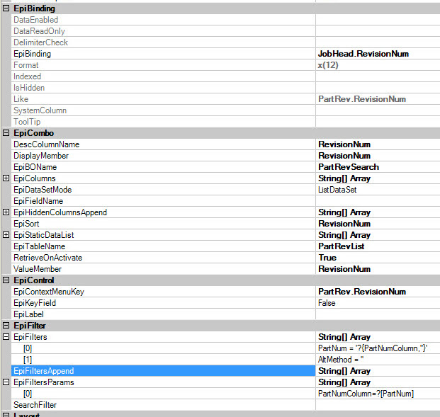

Thanks Jim.
Your screenshot really helped.
I followed the example of what you had in the EpiFilters and had no luck.
I was having a hard time with understanding how the EpiCombo knew what data view to use when all I was using was [CustNum,0].
In my testing, I was not binding the EpiCombo for a field but apparently this is how the EpiCombo knows what dataview to look at. Once I bound the EpiCombo to QuoteHed.Number01, it worked!
