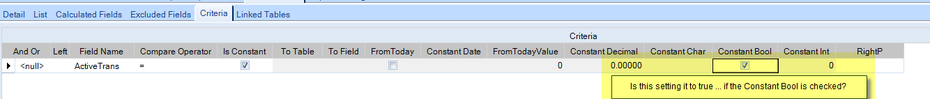

In the Report Data Definition - it is linked by:
1 Company Company
2 JobNum JobNum
3 AsmSeq AssemblySeq
Then in Report Data Definition > Report Table > Criteria -
ActiveTrans - is constant with RValue = True.
Good morning Cathy,
In the Report Data Definition I had the Labor Detail table linked as per your example.
I have never added criteria to a table previously, but I did create the criteria as you described.
However, I am not seeing where you set the RValue to true.
[cid:image001.png@01D2BF2E.D250B0B0]
I hope I am not asking a stupid question…
Carol
Cathy …
I tried it with the Constant Bool checked (my guess this sets it to True) and it worked like a charm.
Thank you so much for your help!!
