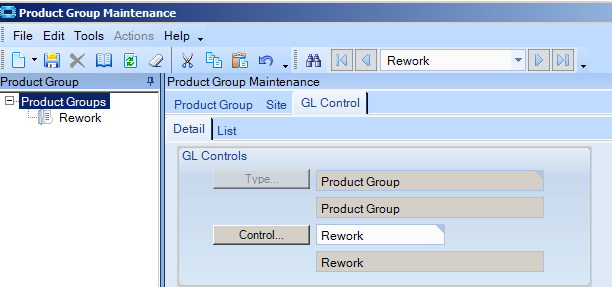

Hi James,
A couple of thoughts, for large rework jobs we setup a job and use product group “rework”. The product code is tied to an account. We can add materials to the rework job as well as labor charges. It’s a bit simplistic but works to segregate accounting for rework.
One other thought, there’s the ability to check an operation on a job as an “added operation”. Now I guess this wouldn’t segregate the accounting of the additional work but would flag that it was added and you could segregate on your own for unexpected labor.
