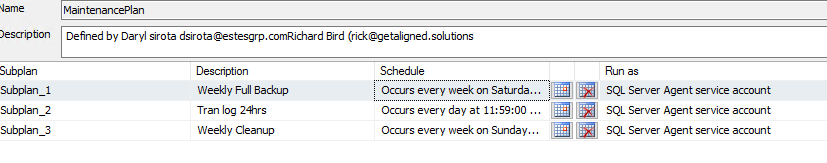

I have finally figured it out. Since our databases are in FULL mode, I simply created full transaction log backups every hour.
How big does your transaction log get at the 1 hour backup interval? And does your server take any performance impact during the transaction log backup?
It’s barely growing since I enabled hourly backups. No performance impact.
