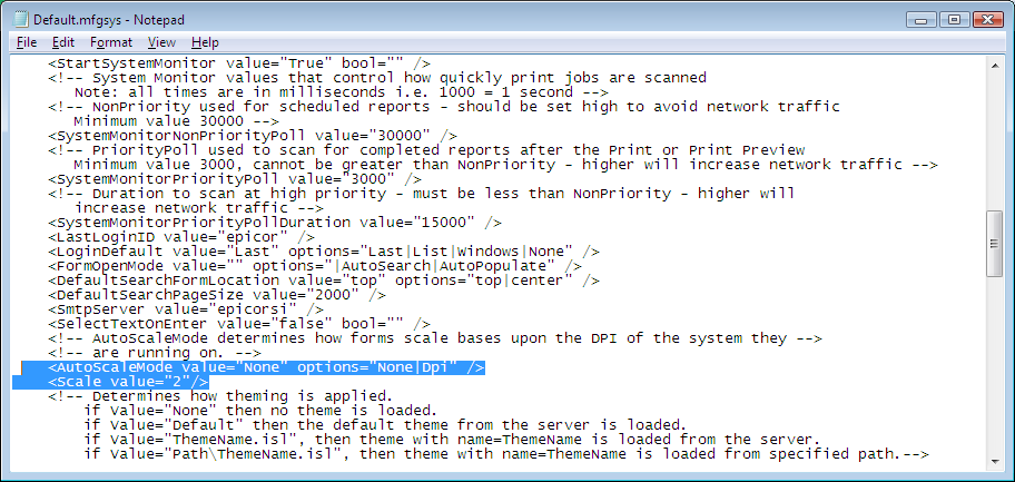

Open the configuration file, edit and Add Scale Value
Thanks Jaicker, that’s already set to 2. It’s scaling like it should be, but any custom controls that I make or even native controls I move around will not scale correctly.

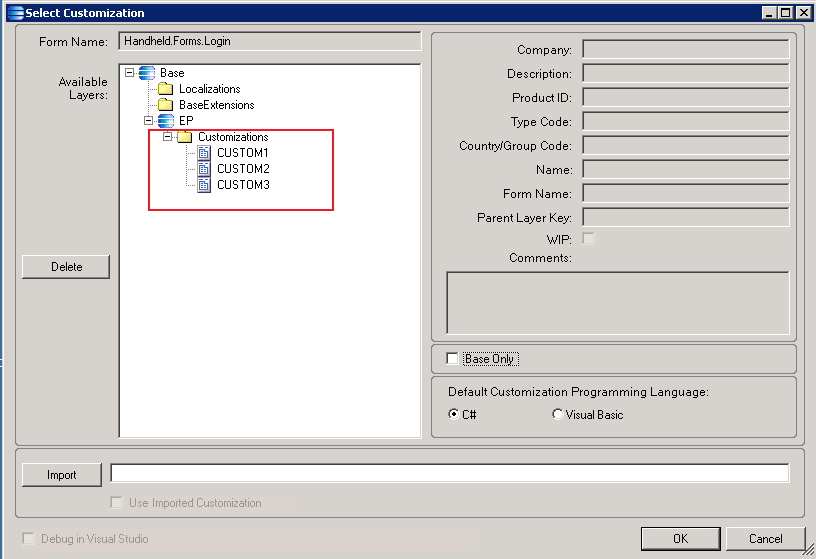

Customizations and custom controls are not affected by auto scaling mode “Automatically”, you should adjust manually after you have selected the scale value, you can use distinct customization layers for each escale that are you use if you have two o more handhel with diferents screen sizes.
You must run mfgsys.exe with “-HHC” option to get into Handheld customization mode and this way you can make customization using the scale value that are you set
Thank you for the suggestion. I think I can find a way to a solution with that. The thing is, I do not have the SDK so I cannot make layers.

You dont need the SDK, with “layers” I mean that you can have one customization for each diferent scale or screen size, then with “Process Calling Maintenance” you can set every menu options for each customization.
You must have one mfgsys config file for each customization
