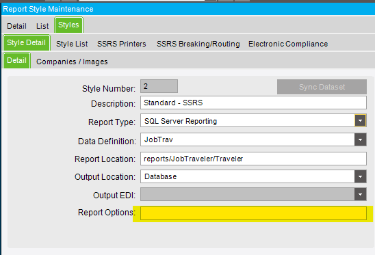

You could use the Report Options on Report Style.
Style Detail - Detail Fields
Report Options
Specifies additional options and settings required by the print program used for this report.
The following options are available in this field:
  • File - This field can be used to specify a directory path for report output. You can only change the file location for the SSRS reports with an Output Location set to Database. When specifying a location and file name, value substitution can be used in the directory path and file name. Note you must prefix the file name with File:, for example, File:{Company}{ReportId}{Counter}.pdf
Thank you. I was hoping to avoid the “overhead” of creating a report but I might have too.
As with all requests, after it is completed, there are always follow up requests to add fields. It would be nice to just add the field to the BAQ and be done with it.
