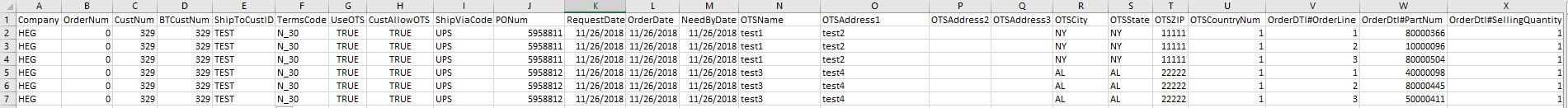

This example will create 2 orders with 3 lines each.
@KPreda, Yes we use custom fields as well. It is cut off at the end of that pic.

Based on 4.0.37.0 for 10.2.200 requirements are the same as you listed. Below is what I limited my template to. I get through 1 - 6 successfully for the first line and the error is thrown on the second line. Every one of my attempts results in an order with only one line item.
