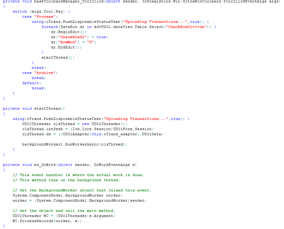

For performance reasons (i am using threading and copied sessions to allow the UI to free up resources for other tasks) I have now moved this into a separate dll which is instantiated on the actions menu toolclick event. This is causing the following issues:

Hi Guys,
Standard coding techniques are employed for the dll, using WCFServiceSupport.CreateImpl as opposed to Ice.Assemblies.ServiceRenderer.GetService because that allows me to pass in a session object. Therefore allowing me to use Session.Copy to prevent the screen locking up when the automation takes place.
Also - i have cut out the BPM thus improving performance, as when run through the BPM it uses the base session and locks the screen when carrying out the issue process.
I am also using a background worker process for the dll asynch threading, which returns a progress update to the ultragrid.
If you look at the conversion workbench in just decompile - my code is replicating that. if that makes sense.
So rest assured, I am using epicor approved standard coding techniques, my only issue is that to reference my asynch dll in customization, it needs to be in the client directory and when it is in the client directory, it needs copies of the server dlls that it references, as above.
when i compile into the server directory, I cannot reference it in the customization xml - assembly reference manager.
does that make sense?
some of the code looks like above.

Jose,
The issue was the context - you saw in my code that I was unnecessarily using context (i converted all calls to adapters except the PartXRef lookup)
Thus when the reference to Epicor.Ice was removed, my problem was resolved.
