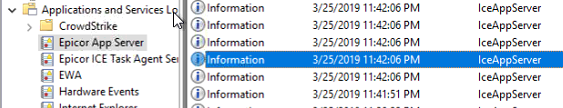

Where do I find the log where the above entry is added?
The flight data recorder as @Bart_Elia calls it aka event viewer on the iis server Epicor App Server.
