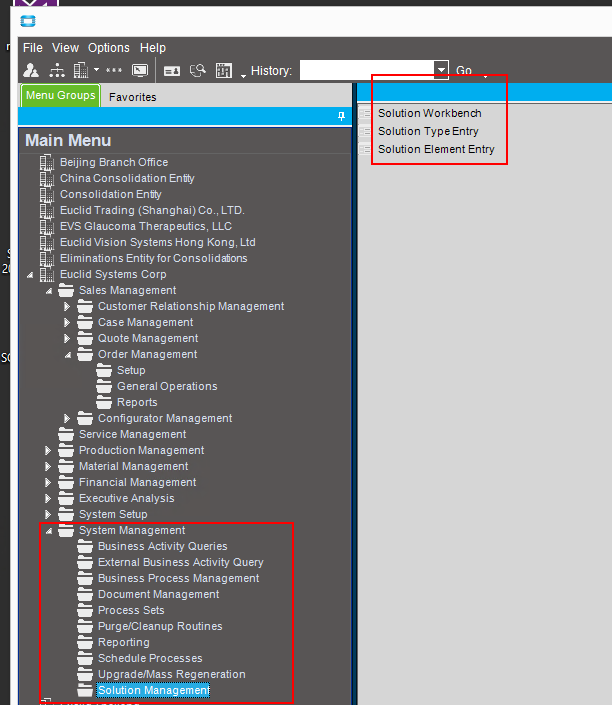

You’ll have to use solution manager or another means to Export the Customization, then Export the Dashboard, Re-Deploy in Production and Import the customization
SM has gotten pretty awesome in 10…
Solution manager? I’ve been doing it the hard way?

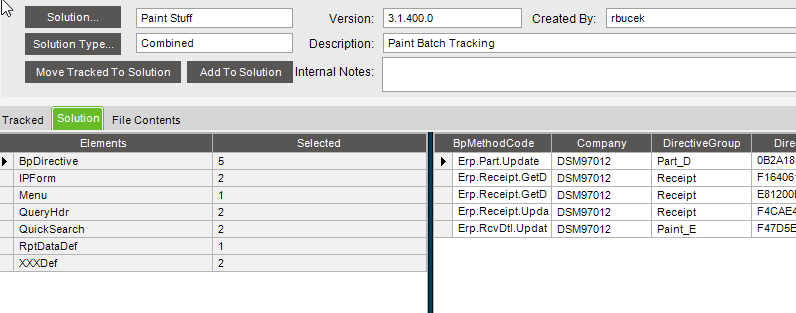

yeah, say you’ve developed a custom business process in a dev environment and it contains baq’s, dashboards, UI’s and bpm’s etc, you can box them all up in a .cab file and you simply deploy it in another environment. It’s very portable, ex:
Damn, I just wrote up an 8 page document with screenshots on how to manually import all of my ‘solutions’ into the Live db to my SysAdmin Where can I find (if its accessible to me) this Solution Manager
Does the solution manager take a ‘snapshot’ of the solutions added or does it actually keep the current copy? I.E. If I make changes to the solution files, do I have to reload them?
Keeps a pointer back to the guid of said record and when you “EXPORT” you get a fresh copy
