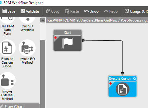

This is a Post-Processing BPM on GetNew in the UBAQ:
foreach (var eachRow in (from t in ttResults
                         where t.RowMod == "A"
                         select t))
  eachRow["Task_StartDate"] = DateTime.Today;
  eachRow["Task_DueDate"] = DateTime.Today.AddDays(90);
  eachRow["Task_RelatedToFile"] = callContextBpmData.ShortChar01;
  eachRow["Task_Key1"] = callContextBpmData.ShortChar02;
  eachRow["Task_Key2"] = callContextBpmData.ShortChar03;
  eachRow["Task_Key3"] = callContextBpmData.ShortChar04;
  eachRow["Task_TaskID"] = callContextBpmData.ShortChar05;
  eachRow["Task_TaskDescription"] = callContextBpmData.ShortChar06;
  eachRow["Task_TypeCode"] = callContextBpmData.ShortChar07;
  eachRow["Task_SalesRepCode"] = callContextBpmData.ShortChar08;
  eachRow["Task_TaskComment"] = "Test";
Stupid Update Time:
So - we had done some testing on our Test environment and were asked to disable all BPMs. Evidently, that turned off the “BASE” Update and GetNew methods on our UBAQ. That’s been fighting me the entire way. SHAKES FIST VIOLENTLY TOWARD THE SKY I enabled them both. Works like a charm. Life is good.
