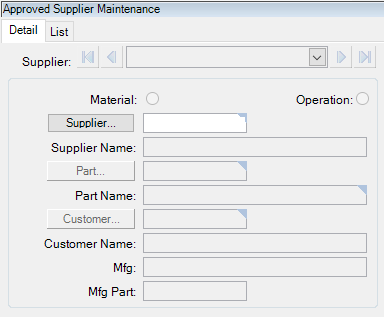

There is functionality out of the box (I think) that allows you to set up approved suppliers by Customer. I would look into that before going down the road of any custom stuff.
Since I need a list of approved supplier for a specific customer/OEM this features is not enough. Also the part made need to have a specific standard on the material used. the only way i see is usin dynamic attributes to force that on the demand side.
You can select approved suppliers for a customer by material or operation. Unless there is something else I am missing, I don’t see why this would not work.
I need 2 extra layers.
approved supplier by: material (ok)/customer(ok)/OEM/part
this is why i said i could create a customer/oem combination as customer
but there is the part layer still to manage .
The part need to ask for a specific standard (astm…) and this standard need to be forced on the demand side.
I’m not sure what you mean by OEM, if it is Manufacturer of the material, that is also included. This is from 8, so I am sure it is in Kinetic.
