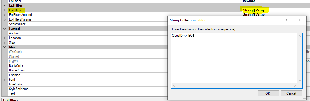

Update, I just found that I was able to hide it from the drop down list by adding a filter.
Still not sure if I’ll end up going this route but wanted share that this was another option.
Which drop-down list? On the PO entry page?
Thanks for sharing
The example above is from the Part Entry screen but I’m sure it can be done on PO Entry as well.
