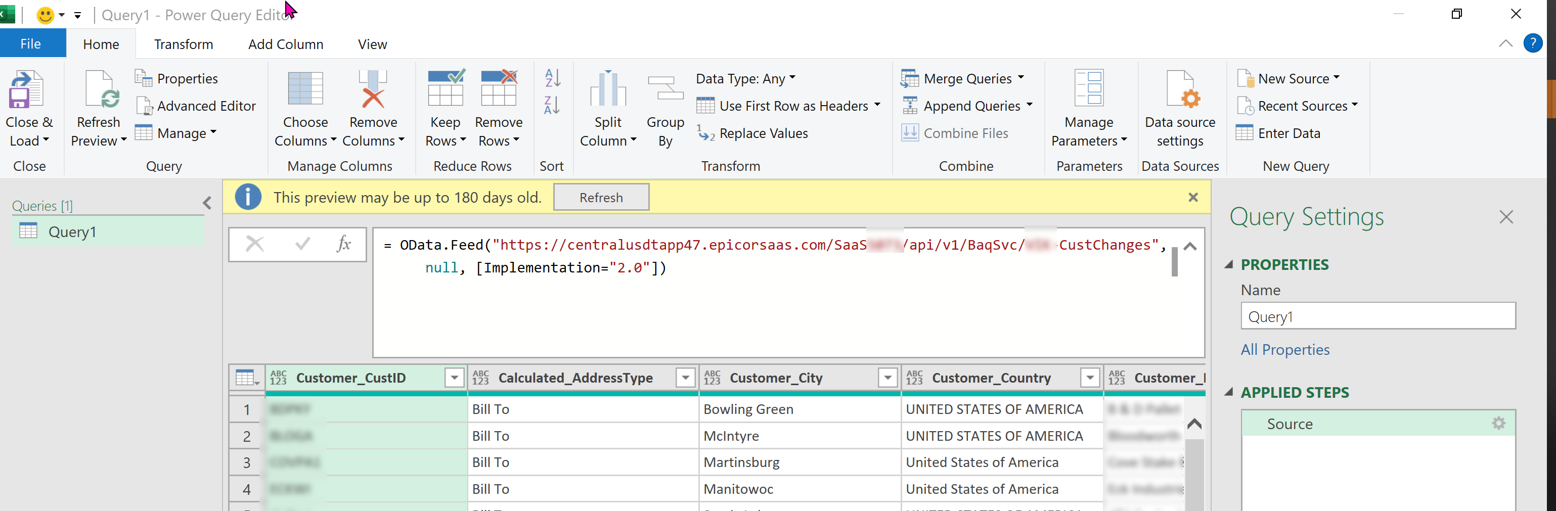

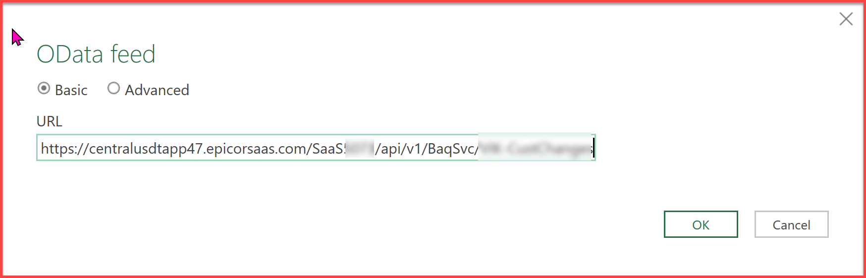

@Jbecht64 Sorry about the delay -
Select Datalink in Excel - OData feed -
https://centralusdtapp47.epicorsaas.com/SaaS**9999**/api/v1/BaqSvc/[BAQ ID]

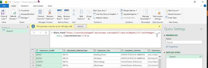

Launch the Power Query in Excel by editing the Excel query.
Here’s the link for BAQs in Excel replace the Bold with your information.
= OData.Feed(“https://centralusdtapp47.epicorsaas.com/SaaS**9999**/api/v1/BaqSvc/[BAQ ID]”, null, [Implementation=“2.0”])
Hope this helps.
