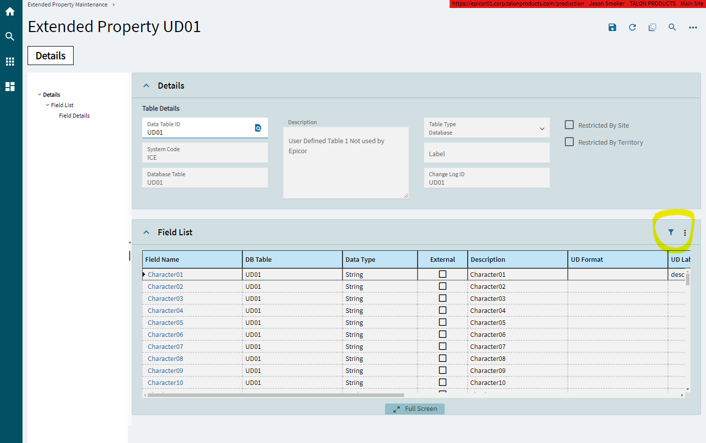

Adding my own fields would be great. I can’t figure out where to go to do that. The only view I’ve found that displays UD information is Extended Property Maintenance. Do I have to be in the Classic version to add fields?
In the screenshot I don’t have an ADD button and the overflow doesn’t have the option either.

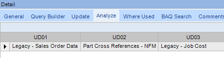

Even worse, if you do like me and never define any labels. Then you have to look at the data in the tables to see what you might have been using it for. I keep a hard-copy list of my UD tables uses. I hate it.
Quick Tip if it helps… I DMT a “Definition” row to every UD table I use to provide details.

I haven’t gone as far as creating a BAQ report to spit this out. But I can query it at any time. You could also spit out a BAQ query like this onto a dashboard and with a click of a button, see what each table is being used for.

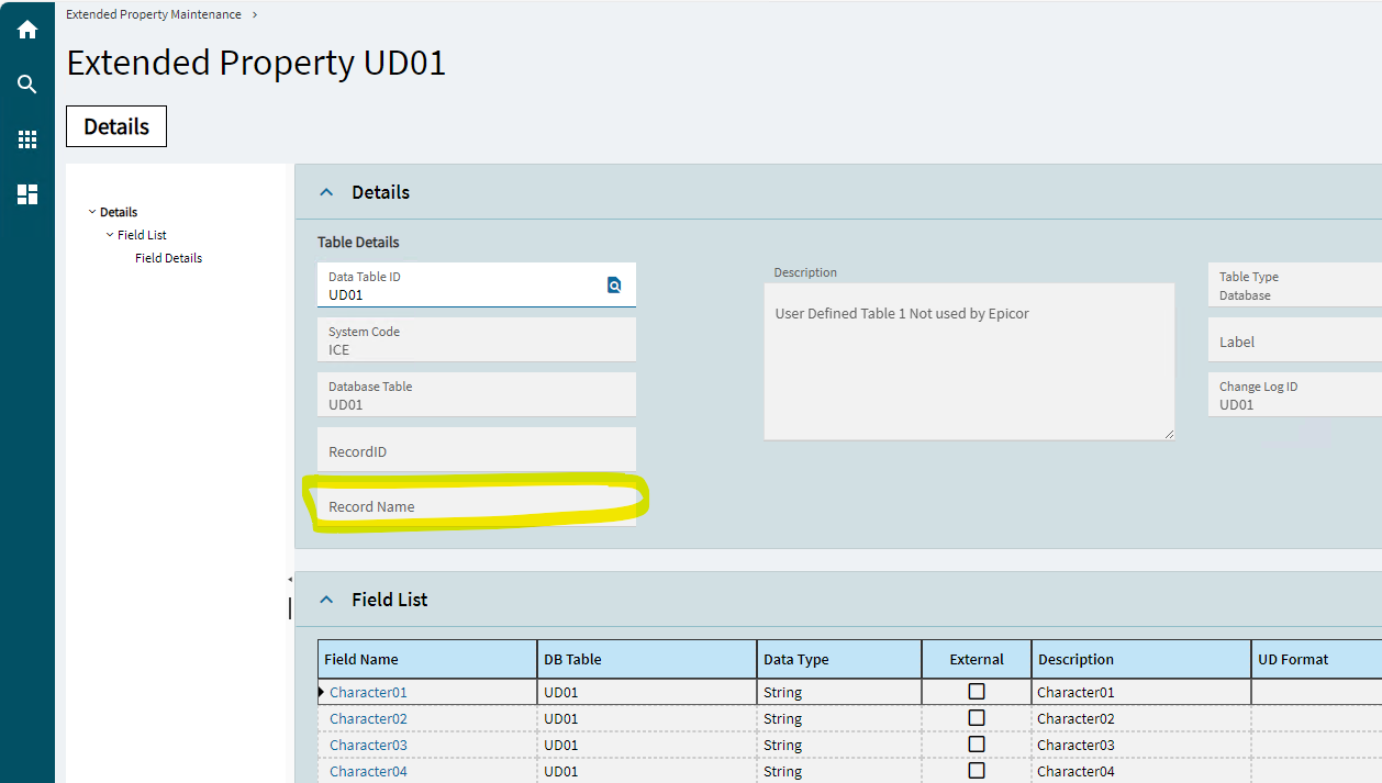

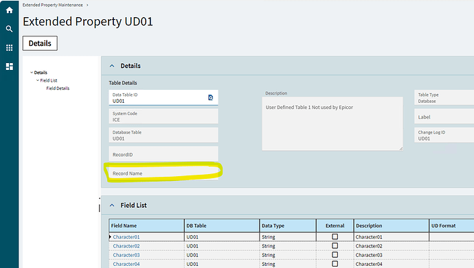

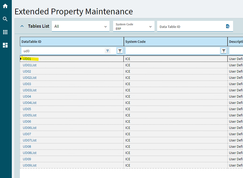

I thought I had a pretty good approach that would fit my immediate needs. I decided to add a custom UD Column to extended properties (something like recordname_c). I got all the way through this approach to adding the new textbox via application studio.
Now the problem is that I’m unable to modify the value in my new Record Name textbox.
I’m assuming there’s something on the view in application studio that’s causing these textboxes to be readonly?

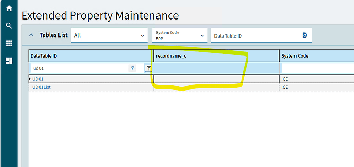

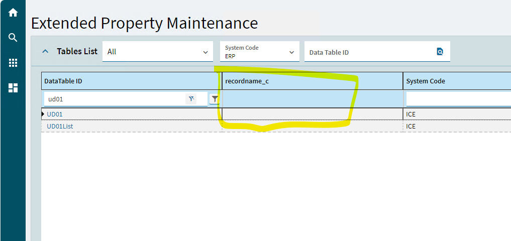

In the interim, since this is a sandbox company, I just went ahead and modified the values directly on the ZDataTable_UD table. The updated values appear in the detail form for the UD01 table but they don’t appear in the list view (Extended Property Maintenance).
Anyone know why I can’t modify the values in these textboxes?

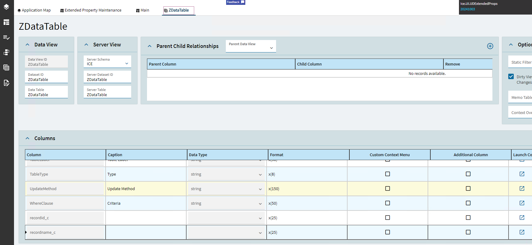

You added your new column to the zDataTable table… but did you add that column to the zDataTable dataview in the Extended Properties app?
I’m assuming you added in the EpBinding to the textbox, but if the dataview doesn’t include that column, it won’t know where to store a value you enter into that textbox. Could be why its read-only.
This would also explain why your grid isn’t displaying values. The DataView doesn’t include that column… so there’s nothing there to reference.
Adding to the dataview is a new thing for me. I haven’t had to do that in the past for other custon UD fields, but maybe Extended Properties is different? Typically I simply load whatever app to view the list of records, go to “personalize columns”, and add the new UD fields.
Am I in the right place in this screenshot to do what you’re suggesting?

All I want to do is add a field as a “description” so I can document what the UD table is used for and make it more obvious on the Extended Properties list which UD tables are being utilized.
I could be wrong (and will accept the public flogging if I am) but I don’t believe there is harm in doing what you’re attempting. You’re not changing any functionality, you’re just adding a reference column to the ZDataTable.
That being said, the ZDataTable has functionality within the system that I don’t fully understand, so, perhaps a more seasoned vet could chime in on any potential impact of taking this approach. (@josecgomez, @Mark_Wonsil, @Banderson)
My further assumptions:
The form loads, and at some point (via event) that DataView is populated by a rest call. If that column doesn’t exist in the DataView, then the rest call would have nowhere to store that column value.
I didn’t think about the fact that you were dealing with a Landing Page. I know adding columns there can be finicky, but I think most people who struggle with that may be trying to add columns from different tables.
In this case, the LandingPage DataView is based on the ZDataTable. So, I may have been wrong about adding the column to the ZDataTable dataview… you may have to add it to the LandingPage dataview for your values to appear there.
Further assumption is that your textbox was greyed out because the EpBinding you were using didn’t exist in the ZDataTable DataView, which is why I assumed you would need to add it there.
You could always set the EpBinding of your field to TransView.recordname_c.
You then would need an event with a row-update to take the value of TransView.recordname_c and pass it to ZDataTable.recordname_c (its final resting place).
