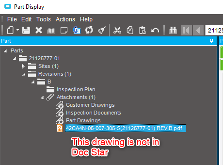

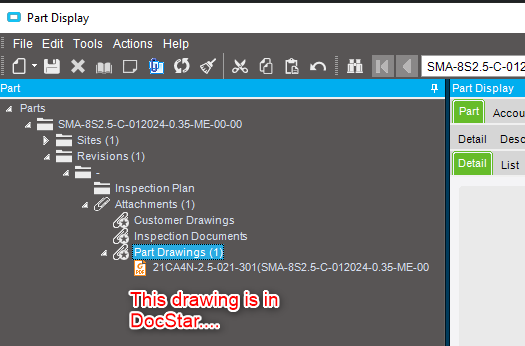

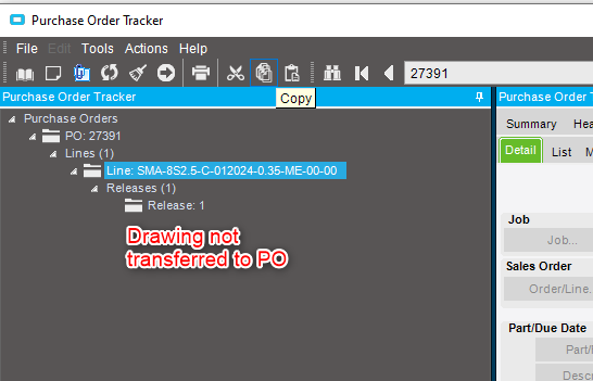

We’ve been attaching drawings to PartRev using DocStar and our engineer was under the assumption they would show up in PO entry screen when Purchasing places an order. Apparently, this is not the case. Purchasing is having to go into Part Entry, grab the drawing from there, save it and then attach to the PO.

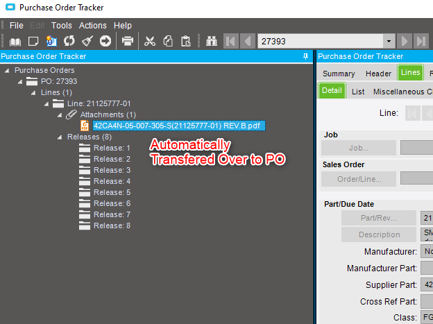

However, I see that if the drawing is saved outside of Docstar (native Epicor attachment), then it will automatically transfers to the PO.
Is it possible for DocStar docs attached to PartRev to be transferred to the PO?
