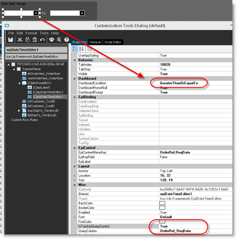

Yes, that can be done.
Customize the tracker view and add some date boxes. Set their settings like shown in the screenshot.
That’s not really the same as using the parameter, it wouldn’t calculate by date range for the rollup. It would only filter the whole set.
One of the uses that I would like to see this is when you have to summarize based on the filtered set, or make a calculated field that uses a parameter.
Does anyone know a relatively easy way to put the parameter into the tracker and have the system use that instead of the pop-up? That would be awesome.
