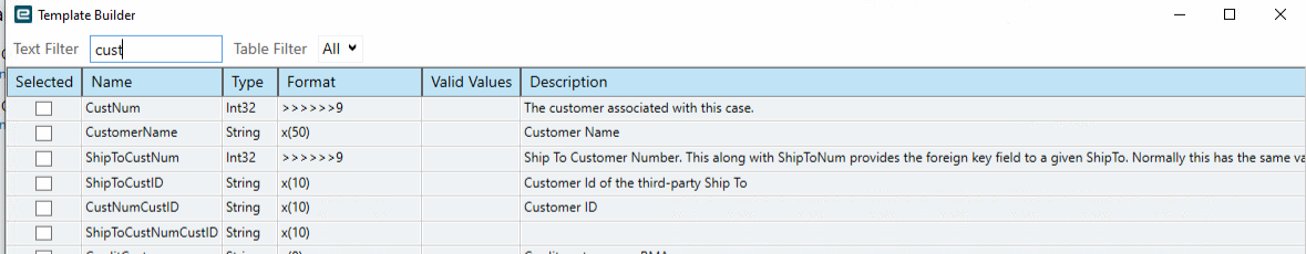

Cases are linked to customers in a number of ways, normally by specifying a customer contact. When this is done epicor sets hdcase.custnum in the background. Thats a an actual table field in hdcase.
In my case our sugarcrm didnt have contacts against cases, just links to customer accounts.
Dmt allows you to set the customer link directly by specifying either custnum or custid, and for the latter dmt calls it custnumcustid, its not stored in the table directly but dmt uses it to actually set custnum via i assume a lookup on the customer table
