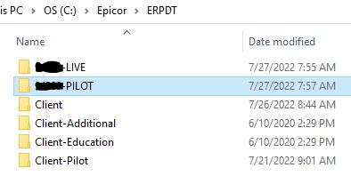

I don’t know why, but at some point I had to reinstall Epicor on my PC. Whatever I did, i ended up with multiple Epicor folders. The older set does not have our Site ID, the new folders do have our site id. When I had this DMT version error, I had to make sure that the DMT I was opening was pointing to the folder with the site ID. I used to only have the “Client” folders. But now that I have the other folders with our site ID in the name, it seems like all the new updates go there. Note the last updated date on the folders.
See screenshot:
This could solve your problem. Good luck!
