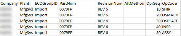

You can update operations with the Bill of Operations template in DMT.
Ross
Not sure how you are managing the revision side of it. If you are overwriting your current revision, use the update flag and update the existing operation. If you are creating a new revision then you will need a new rev, plus operation and materials.
At the bare minimum, your bill of operations template will need the following columns.
You can add CommentText to this for your note changes.

yep Company, PartNum, RevisionNum, OprSeq, OpCode, Plant and ECOGroupID are the minimum fields you have to have to update the table. To update the comment field relating to the BOO this field is CommentText. Pretty simple to do, I believe it will check it out and back in again as part of the process.
