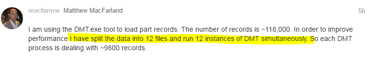

I am using the DMT.exe tool to load part records. The number of records is ~118,000. In order to improve performance I have split the data into 12 files and run 12 instances of DMT simultaneously. So each DMT process is dealing with ~9800 records.
The DMT processes finish loading all ~118,000 records after a few hours. I can confirm this with a simple query in the target Epicor database. This consumes about 85% CPU on the client computer the whole time it is running.
The DMT.exe process then keeps on running and it shows steady CPU consumption and gradual increase in memory. I have let is run this way as long as 10 extra hours and I must kill the processes to stop them.
During these long hours no new records are being added and no log messages are written on the target Epicor server. I am unsure if it will ever stop on its own when it gets into this state.

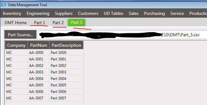

I assume the DMT for E9 is like DMT for E10, and that you launch the DMT application once, and just have several tabs for Part update (one for each block of Parts)
Does each tab run to completion?
If so, can you close that tab, and does that reduce the cpu usage by DMT.exe
