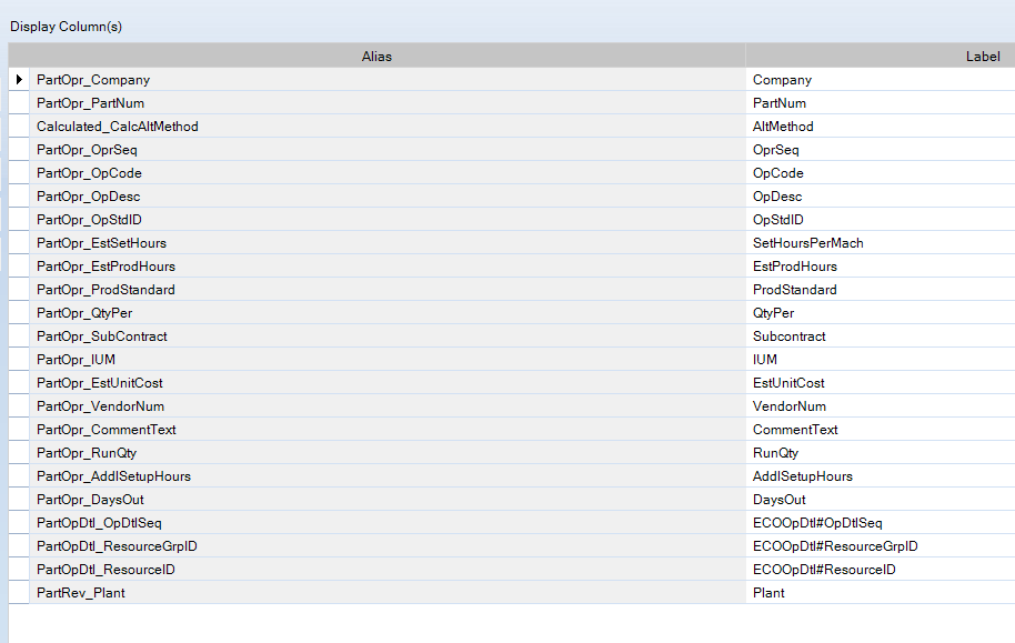

This is what we used frequently in BAQ to get data out then update rev and put it back in. We use UD102 as a placeholder for parts/revs to export to work up DMT. No FinalOpr.\
