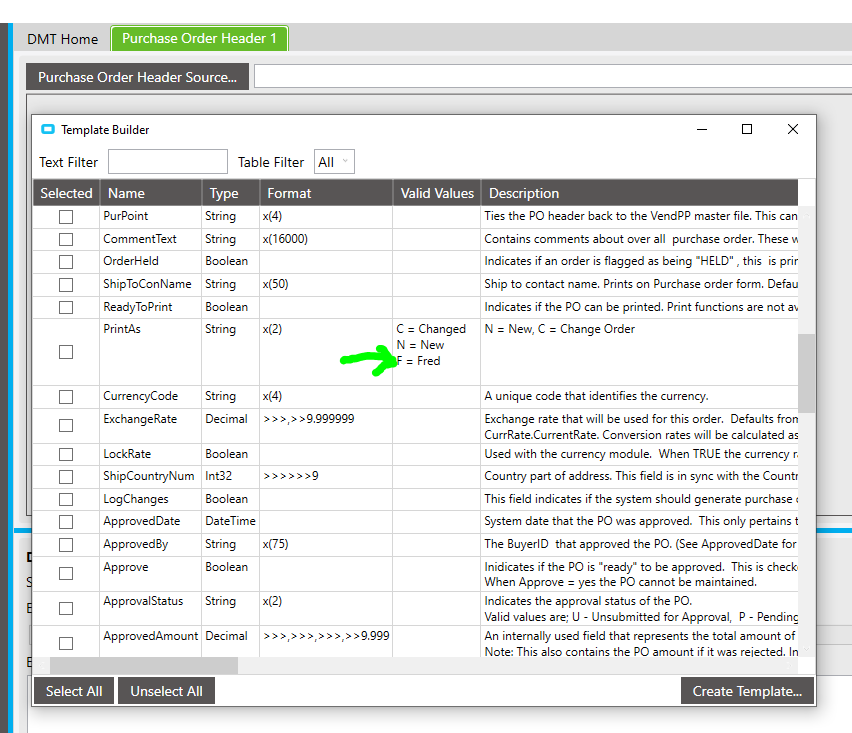

Here are two of my favorites (in one post):
Oh, and this is my favorite Easter egg. For when you want to Print As Fred in a DMT.
Ok that is not in DMT but our metadata for fields - directed to team to correct.
Noooo! I love Fred!
