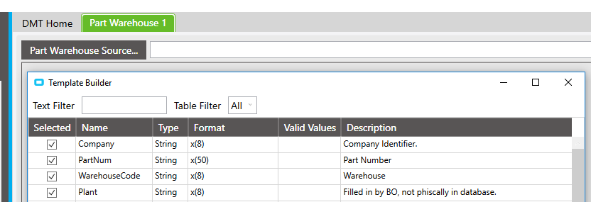

I am trying to make a DMT for unchecking the Manual ABC Checkbox in Part Maintenance>Part>Sites>Warehouse>Cycle Count.
I have all the necessary fields but I am coming up with an error telling me that it can’t find the Part Warehouse. I am at a loss on this one

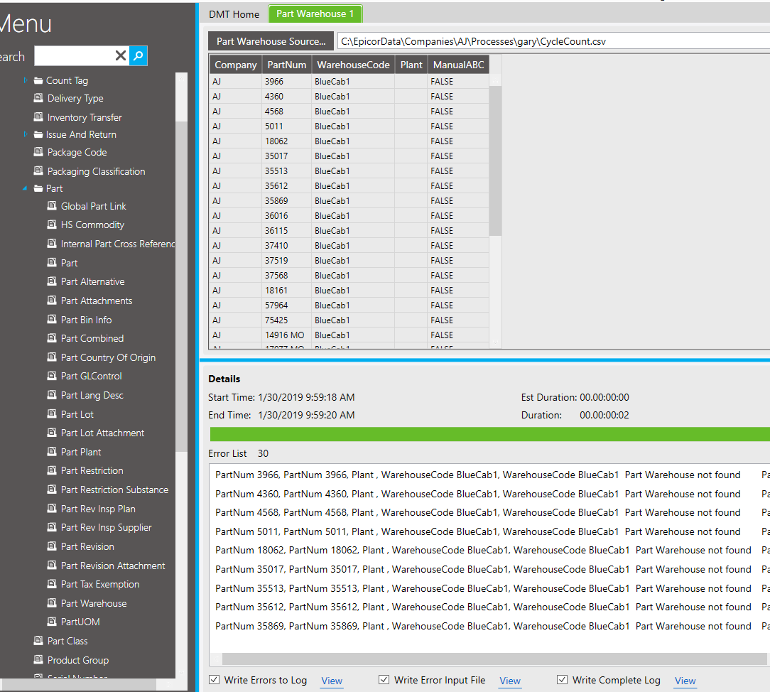

It looks like Plant is blank.
This is it. Warehouses/Bins are tied to plants/sites and your plant column is blank. So DMT doesn’t know which plant your warehouses are associated to.

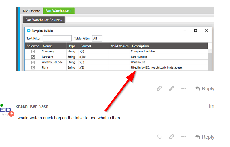

i would write a quick baq on the table to see what is there.
I can’t tell if you are joking??? Even though it’s not in the table, it’s still required for the DMT.
I meant a query on the plant table.

So try your file again with the plant filled in. if you only have one it’s probably MfgSys. Make sure you get the case right. Post a screen shot of the errors.

Make sure you check your case. The fields are case sensitive. And make sure you are using the Warehouse ID, not the description.
I redid everything and it worked. Seems like my main problem was that my BAQ was pulling part numbers that weren’t in Part Maintenance. I was testing with about 10 part numbers and they failed. When I ran a test with about 50 part numbers I saw that some of them completed. Then I ran about 125 and it completed and made the change I wanted in Manual ABC. Then I ran what was left in my test DB and out of 2600 parts there were only 26 unknown part numbers. Thanks for all the help it pointed me in the correct direction.
