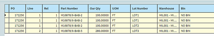

Attempting to Paste new into the Receipt Entry - Lines grid (looks like a grid).
The first Lot adds, but the ‘Our Qty’ fields overwrites with the PO Line ordered qty, then it throws an error on line 2 about the quantity.

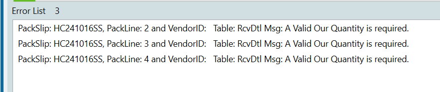

OK, so try DMT. Pretty much the same outcome.
Worked through this help topic https://www.epiusers.help/t/issues-uploading-po-receipts-via-dmt/36367/13 , but same thing, the Our Qty is overwritten.

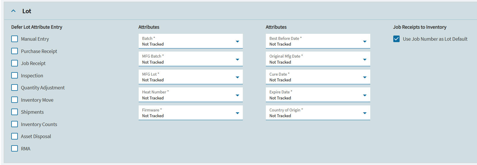

Looking at that configuration though, here’s what the Lot option are:
Maybe that Purchase receipt box needs to be ticked?

This is for skipping prompts about specifying lot attributes when processing purchase receipts.

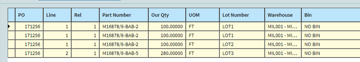

As per last week, it’s loading the first line, with the right Lot number, but the entire line qty, not the Lot quantity.
Adding WareHouseCode didn’t fix that.

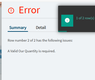

I just tried adding the line manually in the grid, and the quantity overwrites when I hit enter to do the next line.
