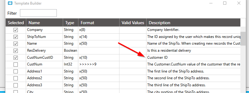

I’musing DMT to uncheck the Residential check box in Customer Maintenance–>ShipTo–>Manifest–>Detail. I used the DMT to make the template, selecting the exact info I was pulling in a baq. To test, I did only one customer and it threw an error. The error was Column ‘CustNumCustID’ does not belong to table.
I am pulling the info in a BAQ from ShipTo table and the ShipTo Name and ResDelivery to populate the csv file for DMT. What am i missing/doing wrong? It processes, shows no errors besides the pop up and nothing changes.

But what is the CustNumCustID, I can’t find that in the customer table or the shipto table.

edit, plus it says Customer ID here.

CustNumCustID is CustID from the Customer table. Worked like a charm!
Just a little background, CustNum (and VendNum) are the internal IDs for Customer’s (and Suppliers). You’ll notice that you can change the CustID and the Supplier ID in their respective maintenance programs. Without some kind of internal ID, you would not be able to do that. This is a newer feature that appeared in E9 I believe and VERY helpful for multi-company processing where you have to sync with other databases. I wish the same was done with the Country table. There’s a CountryNum and ID but often the ID is used as the key. Maybe 10.x?
