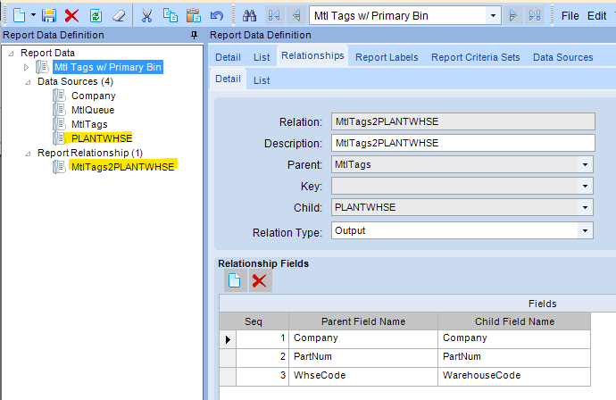

PrimBin lives on the PlantWhse table.
This is not natively included in the MtlTags RDD, nor is it accessible via any linked tables.

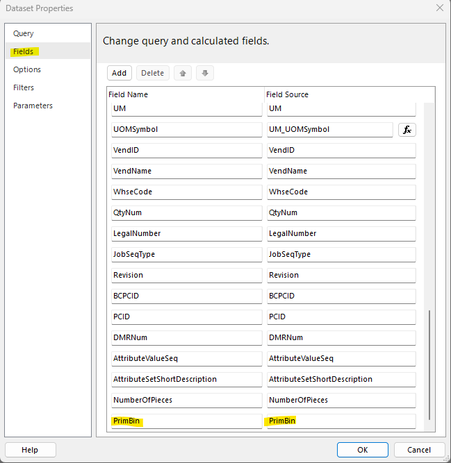

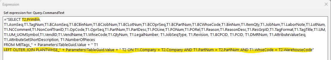

MtlTags has a DataSource called “MtlTags” which is some kind of system query source, not a database table. However, if you look at the query in the RDL, it includes PartNum and WhseCode… which is enough.
You’ll need to add PlantWhse as a new table to your custom RDD. Then add a relationship between MtlTags and PlantWhse where:
Company = Company
PartNum = PartNum
WhseCode = WarehouseCode (note the variation here)
Then add that relationship to your RDL query… add PrimBin to your query and as a query field… should be set.
