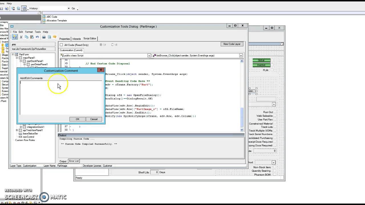

Our company would like to display a picture of a product in the Parts screen. (Epicor 9.05.700C)
I know a picture can be displayed in the Employee screen, Can it be done elsewhere and done anyone have some instructions or example of how to do this?

I made this video for E10 but it should work

Thanks for the video. Could you give a quick run down on what is
oTrans.Factory?

It’s a method that gets the current instance of the given epidata view within the given Transaction

Hi Jose,
I am almost there. Just one tip please…
What is the event that occurs (and that I can use to clear the picture box) when the “Clear the form” button is pressed and the user answers “Yes” to the dialog box?

You can do it in the EpiDataVIew notify event, where the Row = <0 there is a before toolclick event but that will fire before they click yes.
