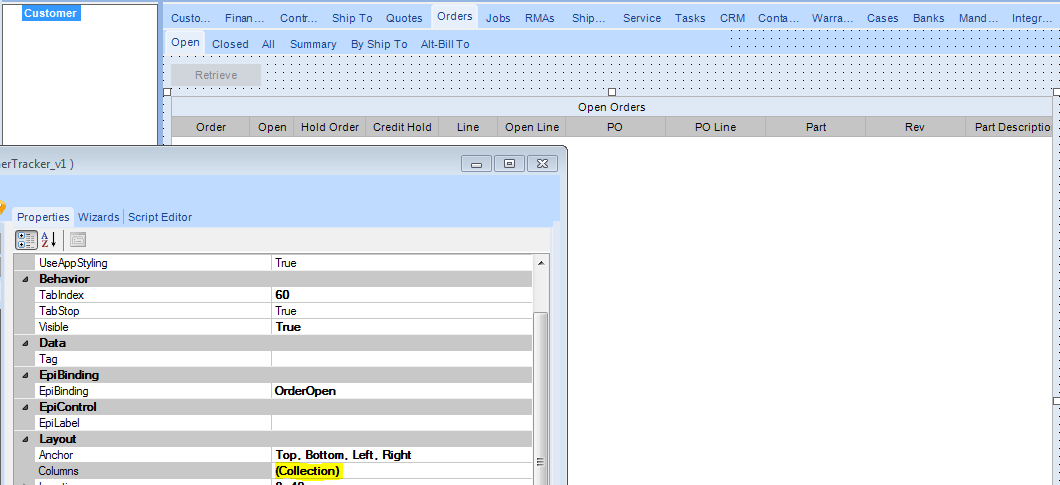

Where would I put the checkbox on the customer tracker? I want the status to appear in the grid marked below.
Then no need to add a checkbox. Select the grid (while in customization mode), and then click the Collection (you highlighted). That should give you a list of all the field in the bound dataview. Scroll down until you find your “_c” field, and unchck the Hidden box.
That’s my problem, it is not there. In fact there are no UD fields in the list.
I just now noticed that grid is bound to the dataview OpenOrder. We need to figure out how to add the OrderHed.MyCol_c to that view.

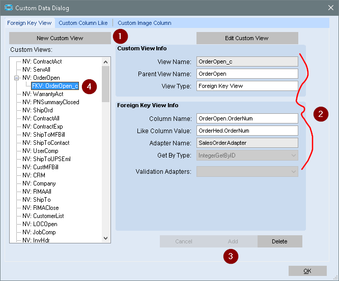

It looks like you’ll need to add a FKV for the view OrderOpen to OrderHed.
  1. Click the New Custom View.
  2. Fill in the fields like so
  3. Click Add
  4. This will show after you’ve added it.
Now add the column from OrderHed
  1. Select the Custom Column Like tab
  2. Select the FKV created above
  3. Select the UD column from OrderHed
  4. enter the table and field name
  5. Click Add Like Property
  6. The new field should appear in the table above (you’ll have to search for it)

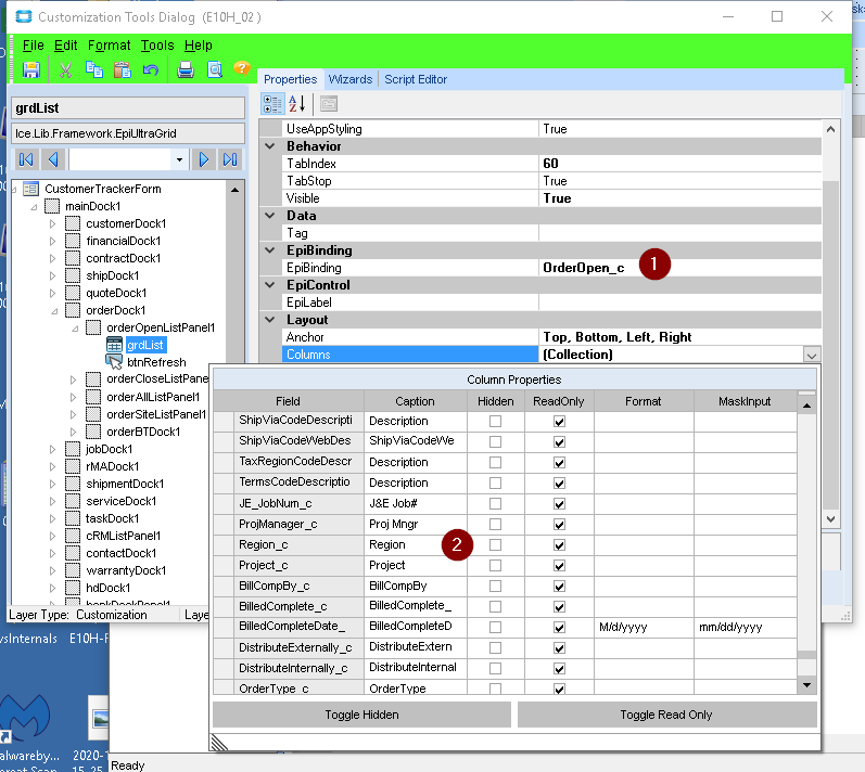

In the Customization window, change the binding to the new FKV, and select the fields to show.
