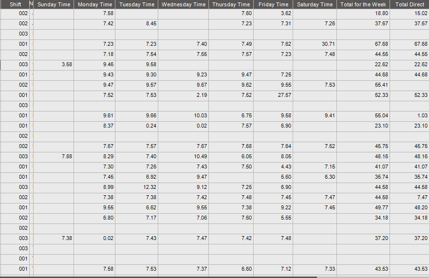

You mean something like this? Each line is an employee, I just have the column reduced to sanitize names.
I see, you made a pivot for each day of the week and have employees listed as rows. That may work for this, in the end it will be a hard copy report.
Thanks.
Yeah, I made calculated fields for the total labor for each day of the week. Then further to the right I’ve got the breakout of it by labor type per day. The whole thing is filtered by supervisor to make it a bit more manageable.
It takes whatever date you enter and returns data from the week it is contained in so it isn’t the most flexible but I’m sure it could be made with different criteria.
