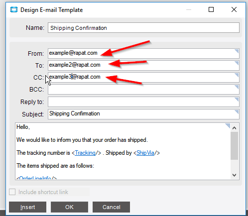

If I type an email address in the BPM would it fix that?

Yes, it would, assuming you can find all the BPMs and reports (yes, reports can send emails) that send emails… Would be very bad to “test” printing of invoices and find that you just sent test invoices to your customers.
