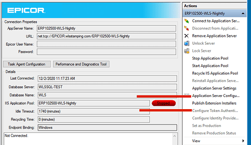

What I am referring to is if I open Epicor Admin Console and click on the AppServer, it will say STARTED or STOPPED. I have one that does not auto-start, but the rest all say STARTED. I want to switch another one so that it does not automatically go into STARTED when the Epicor server reboots.
Under Basic Settings disable the start application pool immediately. That should do what you’re looking for.
