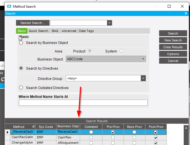

You can pretty easily find all of your BPM’s By searching by the in the directive group. Blank is considered it’s own group, so every BPM that you have will show up.

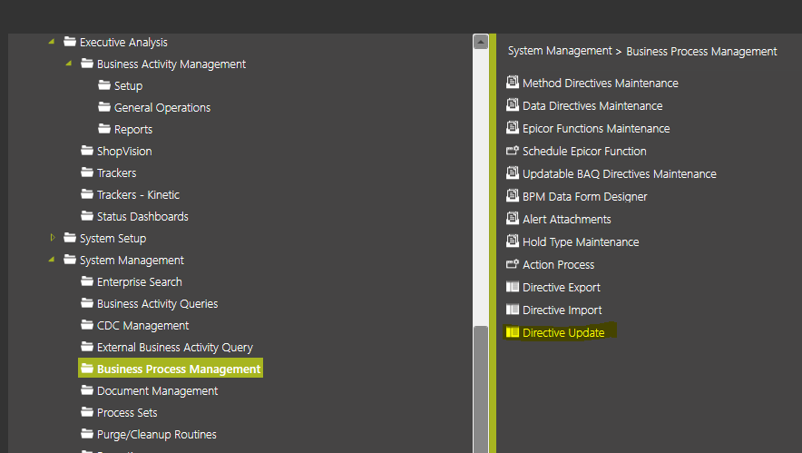

Via the module Directive update
You select your group, and it applies the change enable/disable to the whole group either a data directive or a method directive.
Pierre
But be carefull … in our case, some directives are present but not active… if reactivated via this tool, you could create a some unwanted behaviors…
So maybe slect all your directives and manually check all of them… if inactive, just change it’s group to Disabled (that is what I have done) so the next time I need to addresse a similar situation, I could go ahead and use the Directive Update…

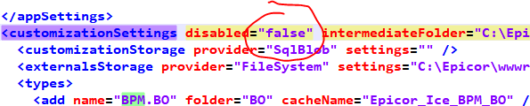

I always do it via the web.config – no IIS reboot needed - you just change the flag, instant kick-in. Then I can enable them again without having to worry which one was enabled, which one wasn’t.
Also once I messed up the Login BPM and couldn’t even login :slight_smile: and disabling them via SQL on my DEV didn’t work they still ran despite switching it to Disabled on the BPM Tables.
