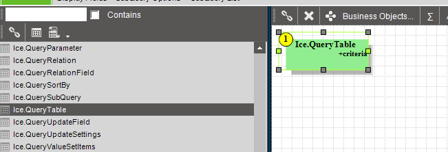

Is there way to look up which BAQs/Dashboards/etc., use a particular table? We need to update our UD05 table and need a quick and easy way to see where all it’s used.
Right after I posted this, I remembered that the Ice schema tables contain all the Epicor metadata. So I looked, and I found “QueryTable,” which appears to contain the information I need or at least give me a good start.
