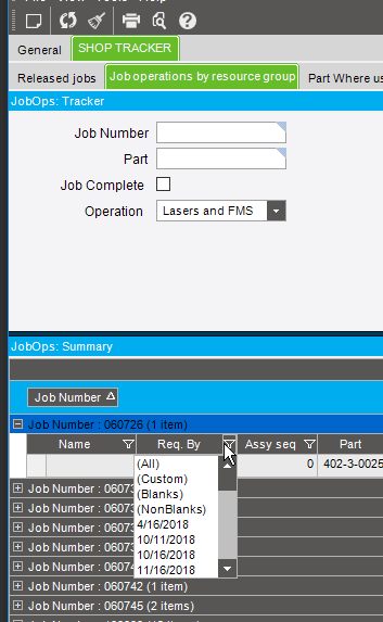

My team and I recently finished developing a nice dashboard for querying and updating certain values. Everything has been going well until we tried to deploy it as a menu item. As soon as we deployed and assigned a menu slot to it, upon opening it, some weird events occur (which were NOT present in the “Test Application” option):
The following image is how the Dashboard is supposed to look when deployed (“Test Application” before deploying), and the one after is how it appears as a menu item (after deploying):
As you can see, for some reason, the “General” tab from Dashboard Maintenance is retained. We’re unsure of why this is happening after it’s deployed, or how to remove it. In addition, we have some custom code with the dashboard that does not get run after being deployed.

I think we’re loosing Group By, Filter… functionalities with a the RunTime Version.
You shouldn’t be.
We just went from 10.1.600 to 10.2.500 and we have noticed several dashboards which now “wake up” in the “General” tab instead of the dashboard itself.
Is this a known E10.2.XXX problem?
