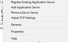

How do i go about re attaching this to our app server ?
Right Click on Server name and click on Register Existing Server, if it’s available it will show in the list and allow you to connect again.
It usually vanishes when you don’t keep it, usually after Admin Console Snap-ins you get prompted. Re-Register it as @fakhruddin mentioned. It may even be still in the XML but invisible due to snap-in difference.
Thanks fakhruddin
Managed to add it back in.
