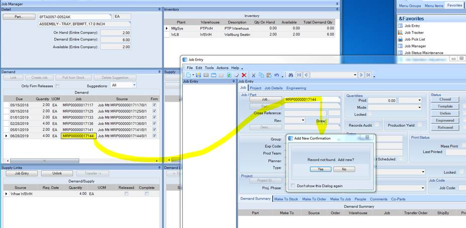

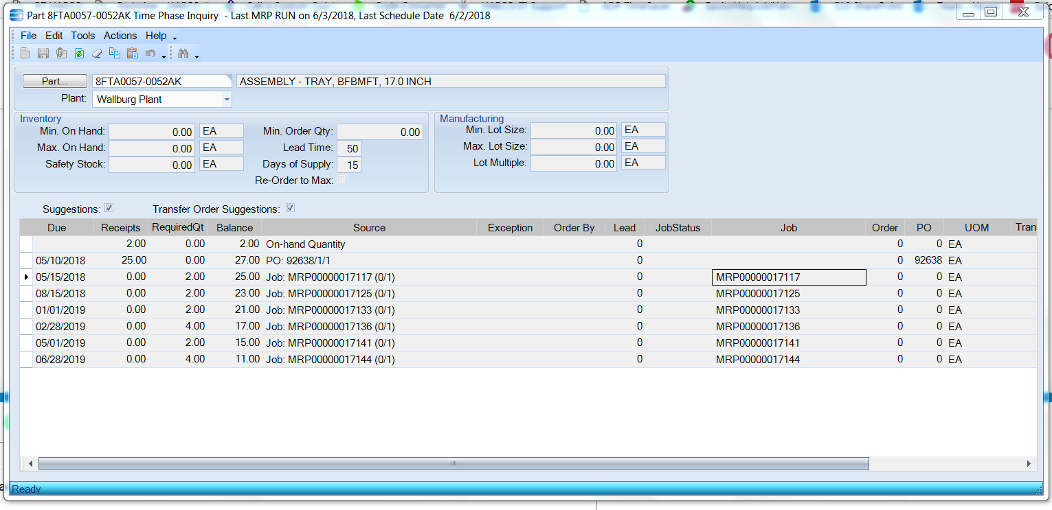

I have a few jobs that were generated by MRP. The demand was removed but when I look in Job Status Maintenance or Time Phase for that part the MRP jobs show up. If I open the MRP jobs they did not exist. Any one know why they are still hanging out there??

Yes still shows up and in Time phase
Check Jobhead table and see if Job number exists there
If not look at partdtl table for the part and see if it is there (this is data behind time phase)
If no job head record and there is an entry in partdtl for the job number - Contact Epicor Support
They can provide something to clean up the orphan record

I do have it in PartDtl not in JobHead.
