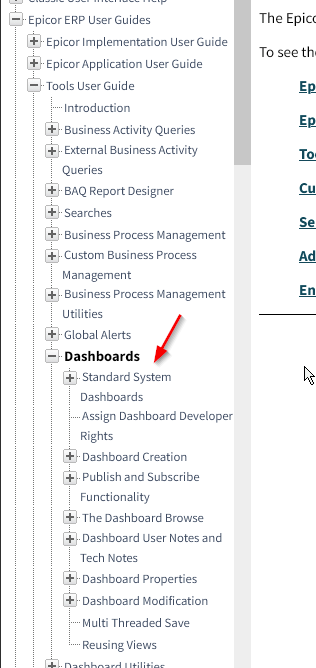

The tools user guide has some really good walk-throughs for doing things the first time, like BAQ’s, dashboard, and that kind of stuff. The help menu isn’t all that intuitively laid out, so if you don’t know it’s there, it can be kind of hidden. But page through that you will be introduced to a lot of things.
