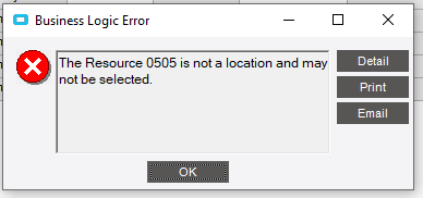

We are attempting to deploy the use of MES to our factory and have run into an issue while testing regarding resource assignment within a resource group. Our methods have all been prepared with an operation and resource group, but left the resource blank. When a job is created, it is defaulting to the first resource within the resource group which is an individual and not a location.
We intend on using MES Work Queue to report labor quantity in various cells. While testing, we were unable to report labor quantity as the resource on the job was not a location. While investigating the resource groups, it simply defaults to the first resource which is a person. Unfortunately the company has not done a good job keeping up with the resource groups, so there are all kinds of people who do not work anymore.
Within the same resource group we do have the locations set up where we’d like quantity reported, but because the job is defaulting to a person it is throwing an error in MES Work Queue. Is there any way to change the default resource within a resource group to a location rather than the first resource in the list or any other ideas?

What we’re running into is it won’t let you start activity because the resource that was assigned is not a location. If I filter by a job and resource group in Work Queue, all the sub-assemblies appear in available work and if I select all to start activity, it will let me report labor quantity on all. But say I’m cell A operator and I only need to start activity on one of those sub-assemblies, it locks you out because the resource assigned to that sub is not a location.
