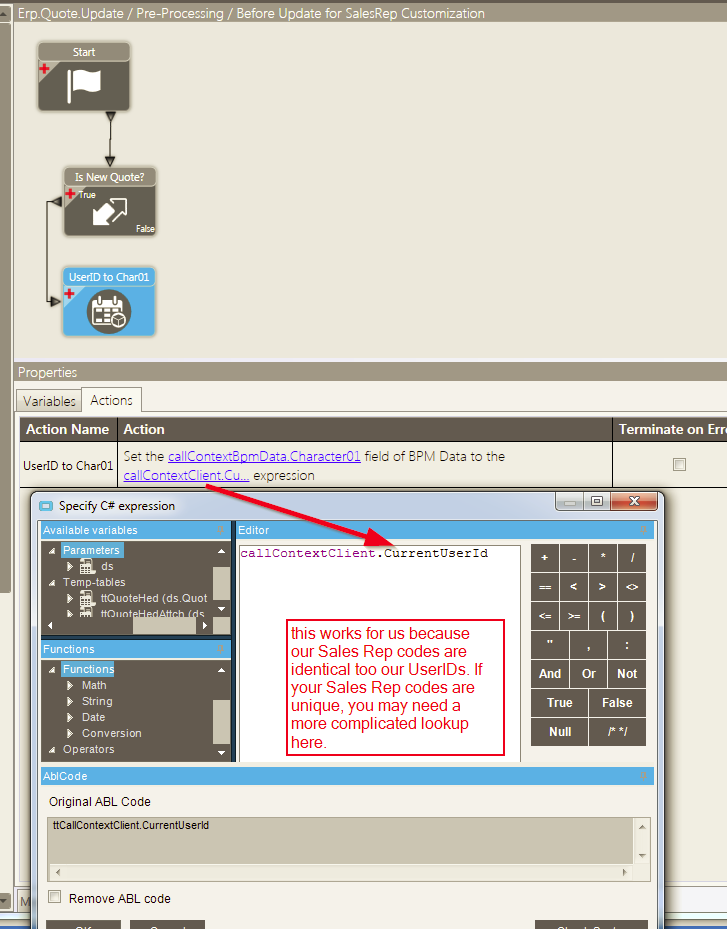

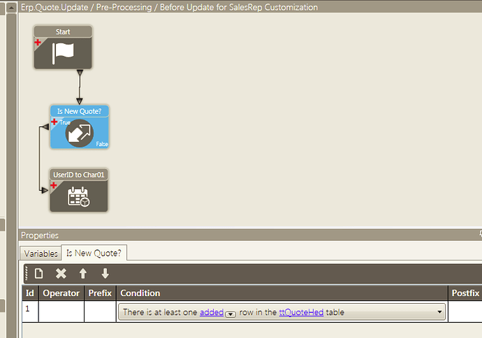

Step 1: Pre-Processing Method Directive on Quote Update

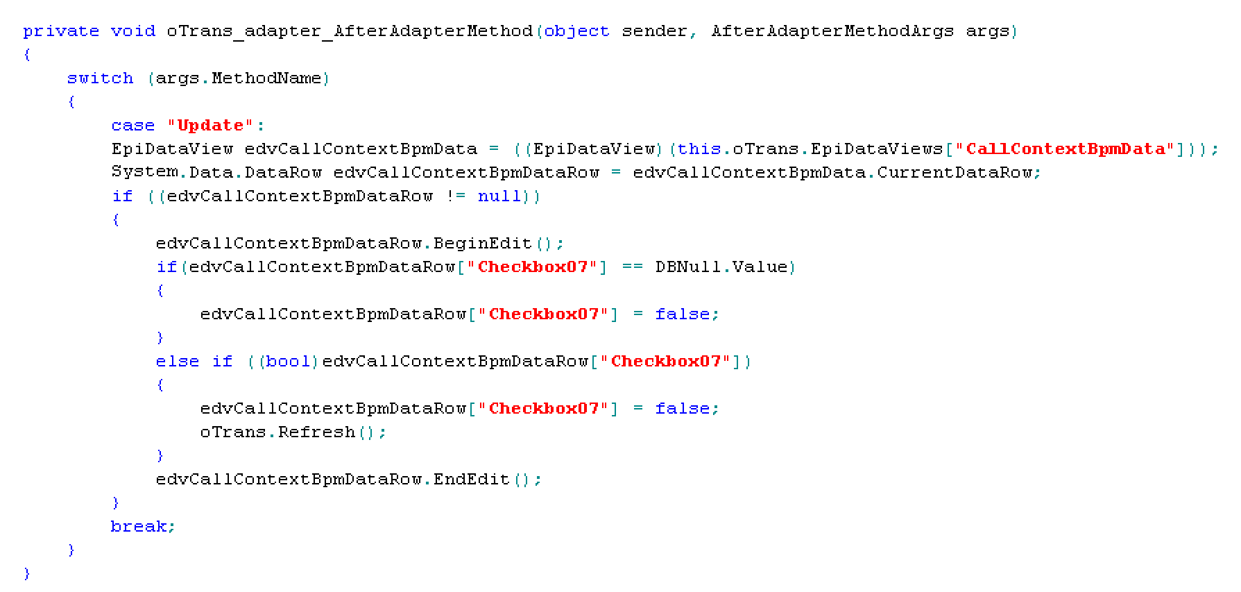

Step 2: Customize the Quote Entry form to change the Sales Rep to remove extra SalesRep and to set the one primary Sales Rep to the value in contextBPMData.character01

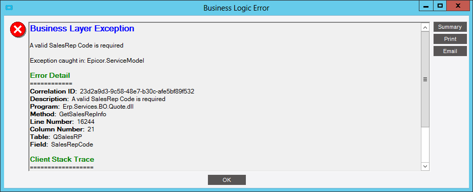

At first I balked at the idea of doing the heavy-lifting in a customization (just didn’t feel right to me), but after trying an absurd number of other approaches, I ended up doing something very similar for Quotes! It still feels a tad inelegant, but hey, it works, it’s performant, and I get to avoid doing any freaking BPM database updates…
Here’s my solution (for version 10.2.500.6). You’ll see from the code that our requirements were a bit different than yours, but it’s just a variation on the same theme:

  Quote.Update | Pre-Processing | RBx2_QuoteSalesRepCleanupScenarios_PRE
  There are several scenarios where Epicor Business Logic causes unwanted Quote-Salesperson behaviors.
  Here, we flag such occurrences by writing the pre-updated ttQuoteHed.SalesRepCode (the current Primary Salesperson) to callContextBpmData.Character02.
  A post-processing BPM fires when callContextBpmData.Character02 != "", and counteracts the unwanted behavior.
  Note - We do not attach Salespersons to Customers or ShipTos, but a Primary Salesperson is linked to each Sales Territory (due to system requirement).

    // trigger another refresh in Quote customization -- UI still shows 2 salespersons in some scenarios until refresh is clicked.
    this.callContextBpmData.Checkbox07 = true;

After implementing you’re solution, I’m still receiving an error when entering a part on the QuoteDtl, “A valid SalesRep Code is required” that refers to the GetSalesRepInfo and QSalesRP.SalesRepCode:
However, when I turn on tracing and take a look at the datasets, they all seem fine to me. The SaleRepCode listed never changes from the SalesRepCode that is set when the quote is first updated. Any thoughts?
