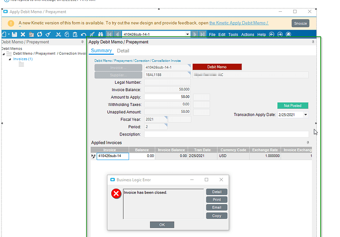

Does anyone have a recommendation on how to fix a paid invoice that was manualkly keyed to the wrong GL account?
Here are the steps we tried:
  1. I created a debit memo for the amount of the original invoice because, the wrong GL account was used when the invoice was posted.
  2. I then created a new invoice for the same amount, applied the correct GL account, and posted it.

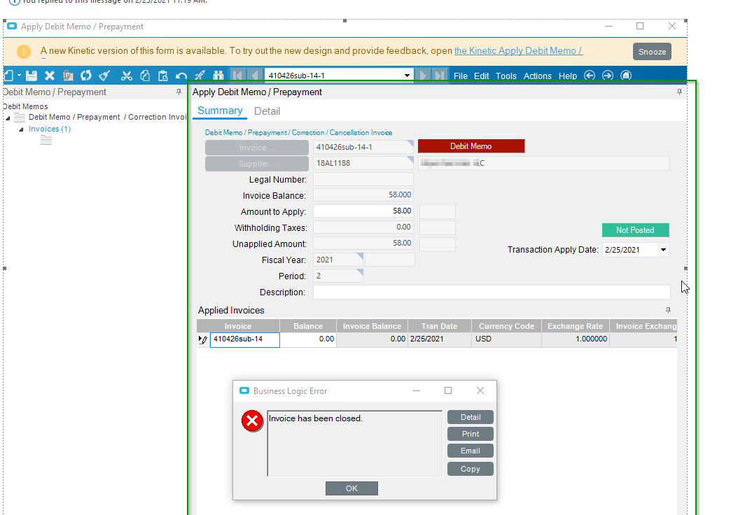

  3. I then tried to apply the debit memo to the original invoice to clear it from aged payables, however Epicor will not allow me to do this because, the invoice has already been paid (This is where we are stuck).
We now have to figure out how to apply the debit memo to the original invoice.
