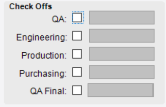

I have been tasked with trapping and displaying dates when CheckOffs are made in DMR Processing. I created a DateTimeEditor for each CheckOff on the Header/Detail tab and modified the GroupBox as shown below, with the code used below that. When I check/uncheck the Checkoff box, the DateTimeEditor reacts as expected. But, when trying to save the data after a checkbox has been unchecked, the DBNull date does not save to the table, and the DateTimeEditor reverts to the previously saved date. Can anyone see what I am doing wrong, or have a better idea how to accomplish the task?

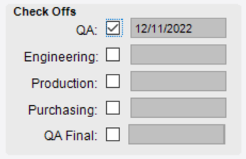

CheckBox Checked and Date correct:

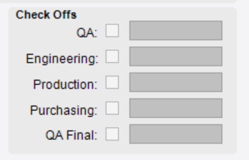

After CheckBox is unchecked:
After Save is pressed:

Looks like I had to revert to the ol’ hidden control trick. Place a control (in this case a read-only blank textbox) behind the control you want to ‘blank’ and use BringToFront() and SendToBack(). A lot of nonsense to fix what probably should work natively, but in conjunction with a directive to update the DB, works in a pinch, no refresh needed. :slight_smile:
CheckOff1 (QA) Checked:
CheckOff1 (QA) Unchecked:
CheckOff1 (QA) Saved (after unchecked):
