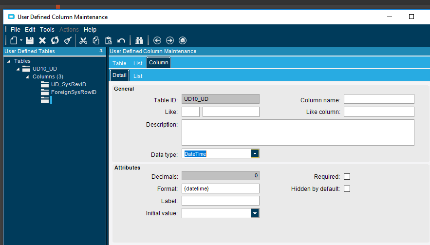

DId you make a custom field for this? Or are you trying to use a native field? If you are making a custom one, I think you can specify the type as DateTime, and then the editor should follow. If it’s a native one, you might be out of luck.
