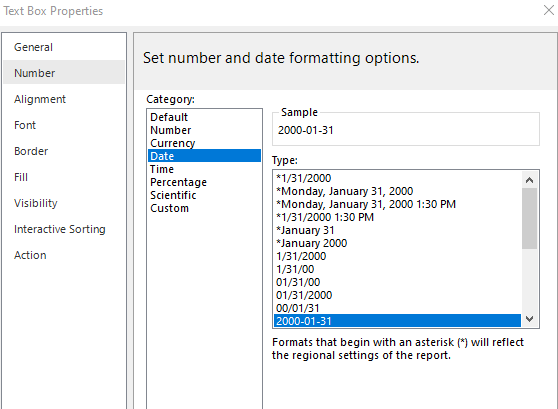

I have a report that gets ran in CSV only and the end user wants the date format of yyyy-mm-dd. I have it set in SSRS and it works in every other format BUT csv. How can I get this date format to stick in csv without having to run it in excel and then save it as csv?
Try converting the field to text in SSRS.
I did. And, it works for any other format, but csv. Which I find very weird.

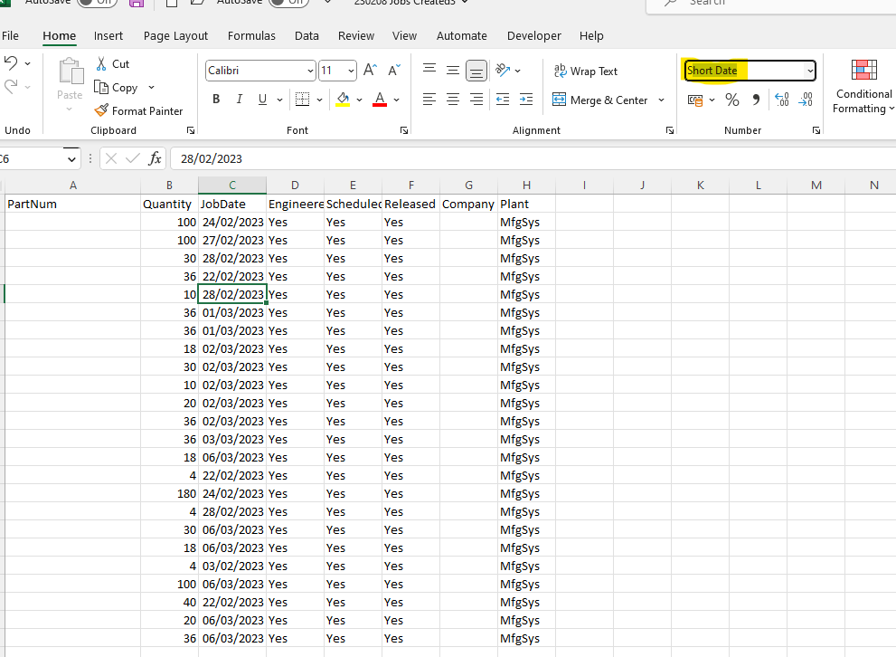

This is an Excel issue. All I can think you can do is run a macro that reformats the date after import. :person_shrugging:

Make a calculated field - of type text - in the BAQ, with the the date in the format you want. Then it’s just a string of numbers and dashes.
I’m assuming the CSV is to be used by some other system and not Excel.
Short Date format works fine for me.
