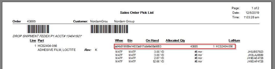

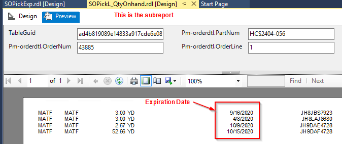

I am trying to modify the SO Pick List by adding a column to the SOPickL_QtyOnhand subreport. In the subreport dataset I have linked in the PartLot table to pull in the ExpirationDate. When I supply the necessary parameters for the subreport and preview it, the ExpirationDate is displayed as expected; however, when the main rdl is previewed (SOPickL.rdl) it shows all the data in each column correctly, except for the ExpirationDate column. There is shows #error. Since this is a subreport, there is no formatting on the SOPickL.rdl, so I am perplexed.

Does the sub-report use data from generated by the RDD? Or does it have its own query, pulling straight from the DB?
Generated by the RDD.

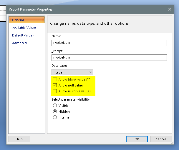

You don’t accidentally have a default value set for any of the params in the subreport, particularly the GUID.
That is a very good question as I am known to add a default value and forget to revert it back to none, but in this case they are all set to none in the subreport.
No, none of them.

It happens on every instance when the subreport is shown.

Sorry for the delay in getting back to you. I ran this report again from within Epicor in order to produce a new GUID in the Ice.SysRptLst to use in SSRS as the old one expired. Once I did this and added the new TableGuid to the report in SSRS, the date started to appear correctly! I have absolutely no idea what changed, but I did not make any changes to the report itself. Perhaps there was some corruption in the prior TableGuid???
