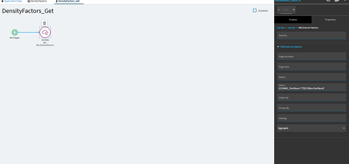

I created a baq and then created a dataview to bind the baq.
but I need filter the baq with partnum. i put the conditon in the where section. but it doesn’t work. without the filter, i got the listin the grid. but if I added the filter, i got empty in the grid.
is there a syntax error?

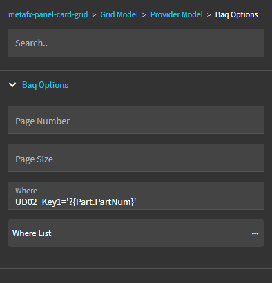

I’m not exactly sure if you need to filter the erp-baq event. If you have a Dataview for the BAQ, you can just let all the values/rows come in… but then filter it on the grid where you’re displaying the desired results:
Pick the grid you’re displaying the BAQ results in…
… open Data > Grid Model > Provider Model > BAQ Options.
You can put a “Where” clause here to filter what’s being displayed in the grid.
Below is an example.

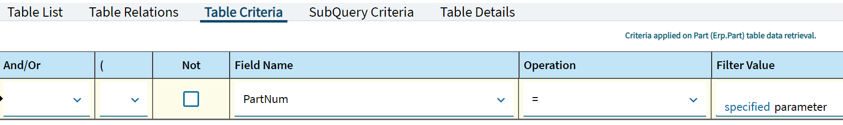

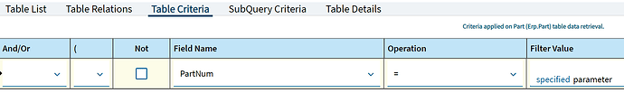

In your BAQ you can add a table criteria for PartNum and set it to ‘specified parameter’. Then click on the word specified to setup the parameter. This creates a user prompt when running the BAQ to filter by that 1 part number(dataset won’t populate until parameter is set). You can then turn your BAQ into a menu with the dashboard tool(I’m glazing over some steps involved here).
Remove the ??.
That syntax is not used here.
ECOMtl1_PartNum = '{ECORev.PartNum}'
