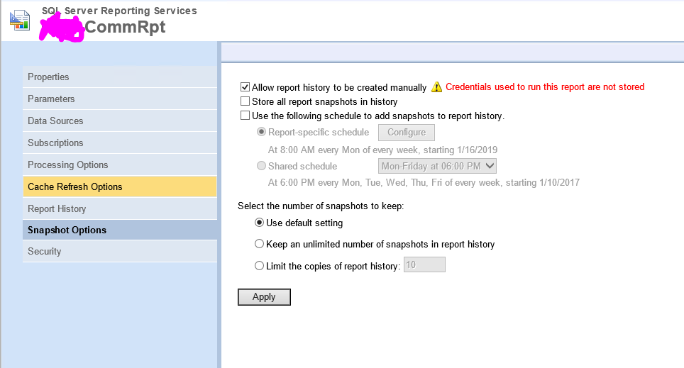

For things like this I use SSRS. I create a subscription that emails the report to whoever needs it, individual or dist. group. That way the data stays static but can always be viewed live from report manager. I have yet to use snapshot, but i believe it will just save a copy of itself in report history to be viewed/downloaded later.
Edit: just tested with store all report snapshots in history and it put it right in report history.
